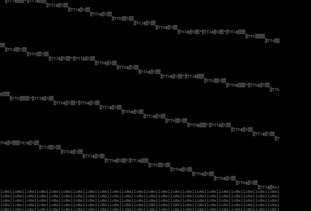

I have setup UART1 clocked with HSI clock, with drivers version 1.16
Which led to incorrect output on the line.
Same code with drivers version 1.14 worked completely fine. See picture.
Turns out HSI trimming value is not correct in clock setup

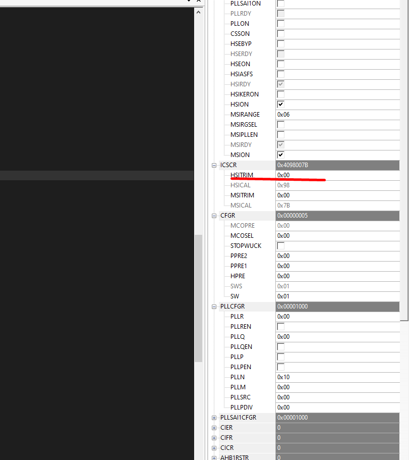

Also, when I entered debug mode and checked actual value in the register, in first case it was the same, but in second case it was 0, instead of 0x40u.
Substituting value manually to 0x10u solved the issue.
