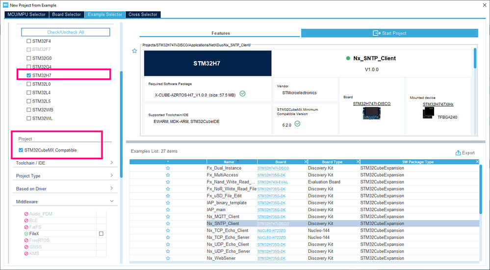

In the STM32H7 Example project, the CubeMx .ioc file is missing.
Does CubeMx support STM32H7?
Could anyone please tell me about the above?

Hi @Community member ,
To have the full list of H7 example with ioc you can refer to Example Browser in CubeMX using the filter "STM32CubeMX Compatible" .
The result table contain all examples with ioc.
Hope this helps you.
Houda

Dear @Community member
If you are talking about the availability of .ioc files in STM32CubeH7 examples, unfortunately this is not available and all provided examples are developed using HAL driver.
But STM32CubeMx tool support STM32H7 family and you can configure your project using this tool then you can add your user code.
If this answers to you request please select this as best.

2021-07-14 6:00 AM
Full CubeIDE based examples with .ioc files are available for G0, G4 series. Example.
Houda
