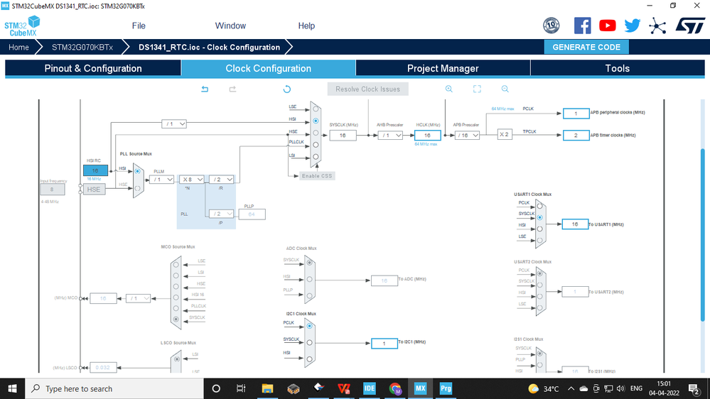

2022-04-04 3:54 AM
shouldn't you enable LSE for RTC sake?
