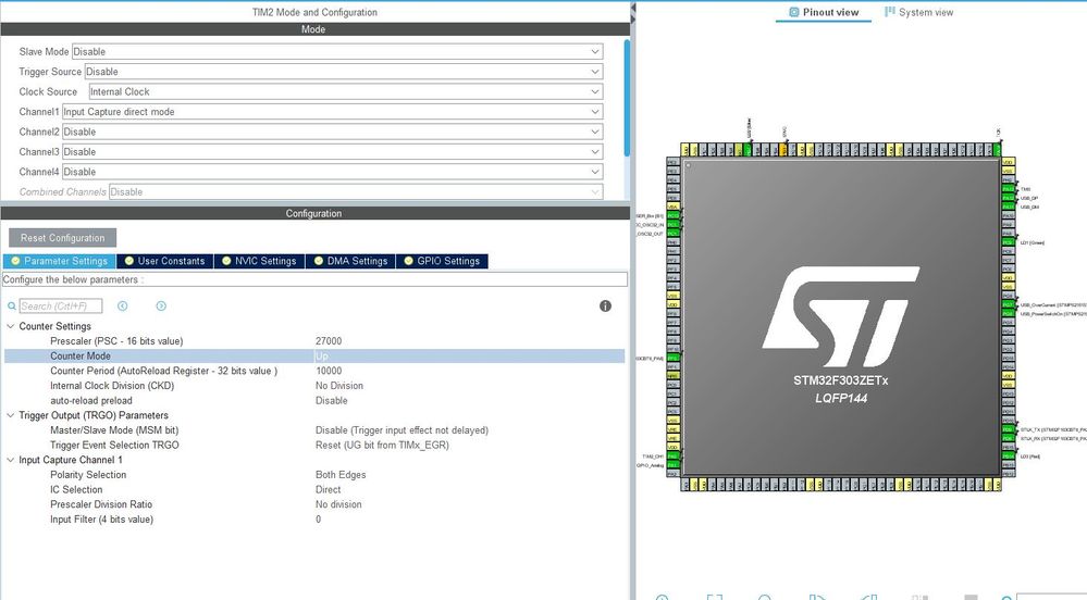

if someone could please attach a picture of the stm32cube setup in order to read the Pulse Width (Pin 2) from the sensor i want the internal timer to start on the rising edge and stop/capture on the falling edge of the signal here is the setup i'm currently trying :
Any help would be much appreciated I'm very new to using timers and tried reading the timers cookbook but after 12 setup attempts i get an output that changes but i cant seem to figure out if i'm doing it right

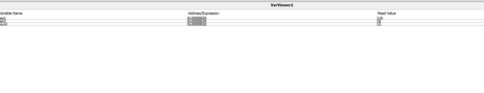

}hers a snapshot of of output the values change i'm just no sure if it's right:

hi,
prescaler value is too high.
suggest to put as prescaler value Tim2Freq/1000000 to have one microsecond resolution and to put at Auto Reload Register 0xffffffff ( the maximum value.)
there is no need to zeroize timer inside callback .
Save the two last captured values (as you already have done) and subtract the value cached by rise callback from the value catched by fall callback. (eg. cap2-cap1) The result will be in microseconds an you can convert it to inches by divide this by 147 (as writen in datasheet of the sonar)
2019-04-09 2:18 PM
Thank you vangelis i solved it thanks to that i changed my code it to have a 2 channels (1 direct on indirect) one for rising one for falling capture. The key to getting a nice looking output was as you said changing the prescaler to 72.
