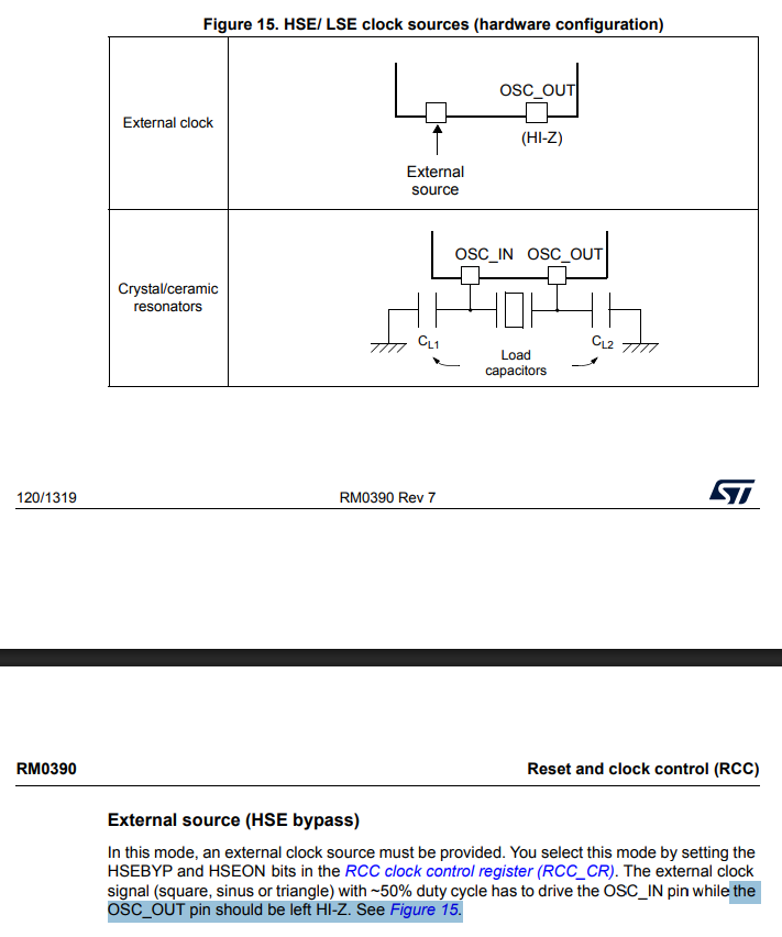

In the RM i found out that, when using HSE BYPASS mode, PH1 (OSC_OU) should be left in HI-Z state
What does HI-Z means in STM32 MCUs? does it mean configuring the pin as digital input? or it means configuring the pin as analog input?
Indeed it does - here is the full context:
https://www.st.com/resource/en/reference_manual/rm0390-stm32f446xx-advanced-armbased-32bit-mcus-stmicroelectronics.pdf#page=120
@mƎALLEm Indeed, this wording is misleading: it suggests that this is something that the user has to actively do - which, as you say, is not the case.

In this case, PH1 is Hi-Z by default. No action necessary. The "should be left HI-Z" wording seems. Not like it says "should be changed to Hi-Z".

from rm:
"should" is a bit ambiguous, like: better dont touch it, leave it unconnected; to avoid "side effects" - if it works at all.
