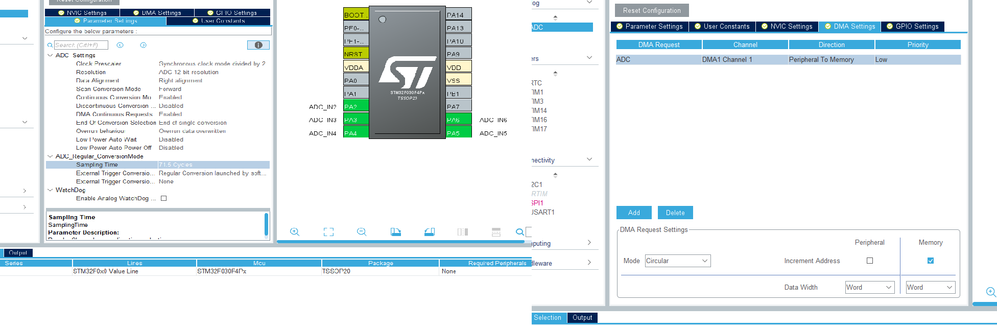

Okay, i have working code. I just did what says the example(before i wasn't about examples in documentatnion).
If somebody will also problem with it, heres solution.
Cube conf:
And code:

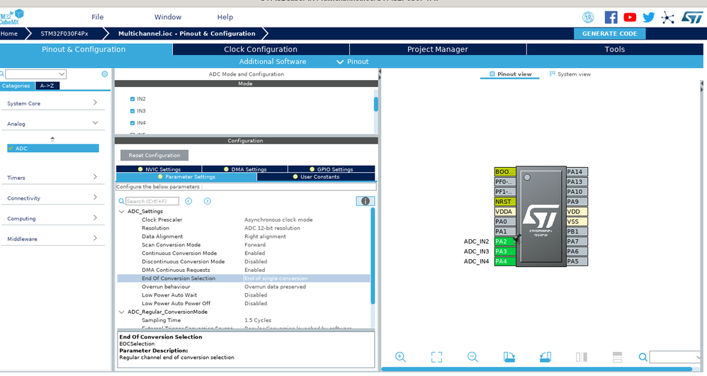

My currently conf is:
My code:

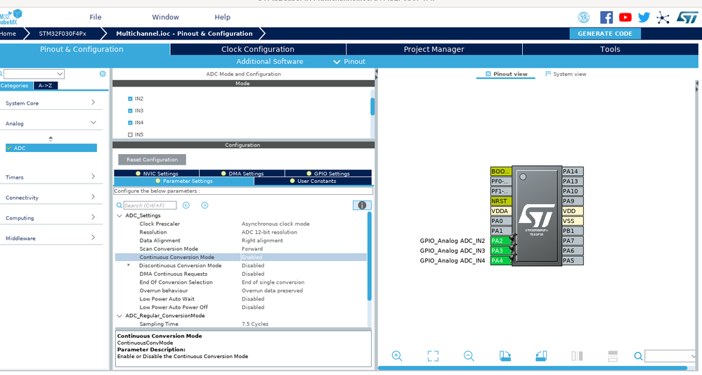

OK, i cant do it, it's too difficult. Lets try the Polling mode. Now my conf looks like this:
And my code:
/* USER CODE BEGIN PV */
uint16_t reading[3];
/* USER CODE END PV */
/* USER CODE BEGIN WHILE */
while (1) {
HAL_ADC_Start(&hadc);
HAL_ADC_PollForConversion(&hadc, 200);
reading[0] = HAL_ADC_GetValue(&hadc);
reading[1] = HAL_ADC_GetValue(&hadc);
reading[2] = HAL_ADC_GetValue(&hadc);
HAL_ADC_Stop(&hadc);
/* USER CODE END WHILE */Now, readings from 3 channels are completely random. I set three pots, first(CH2) have grond on output, second(CH3) have some from 1 to 3V, and the third(CH4) have Vcc potential(3.3V).

Yes. As clive pointed out, set up DMA ADC conversion to place the 3 conversions in a buffer. Poll the DMA transfer count, and when it decrements to zero, read the buffer values. Or, you can set up a DMA interrupt to trigger when the DMA count is zero.
There is a DMA ADC example in the library package. Usually the example converts one ADC channel, you will have to modify it to convert 3 channels.
Cube conf:
And code:
