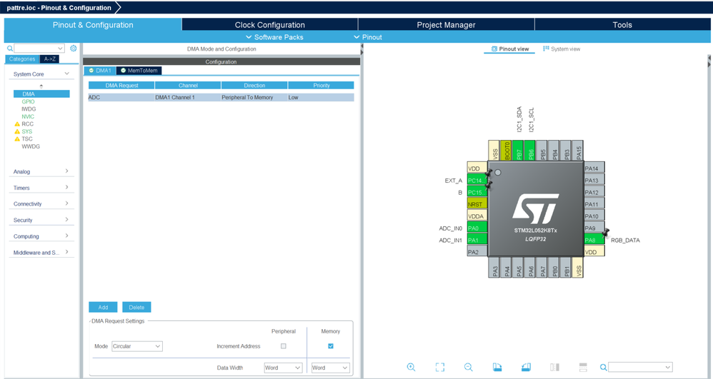

First of all, please use the "</>" button to post your source code.
Then, what KnarfB said, and have you set the DMA to CIRCULAR? Or doesn't this STM have this DMA feature?

As you said to ENABLE hadc.Init.DMAContinuousRequests. I done it, but it's not working. After enabling it, lcd not printing anything

2024-07-31 12:03 AM - edited 2024-07-31 12:03 AM
Thank you for your feedback and it worked.
