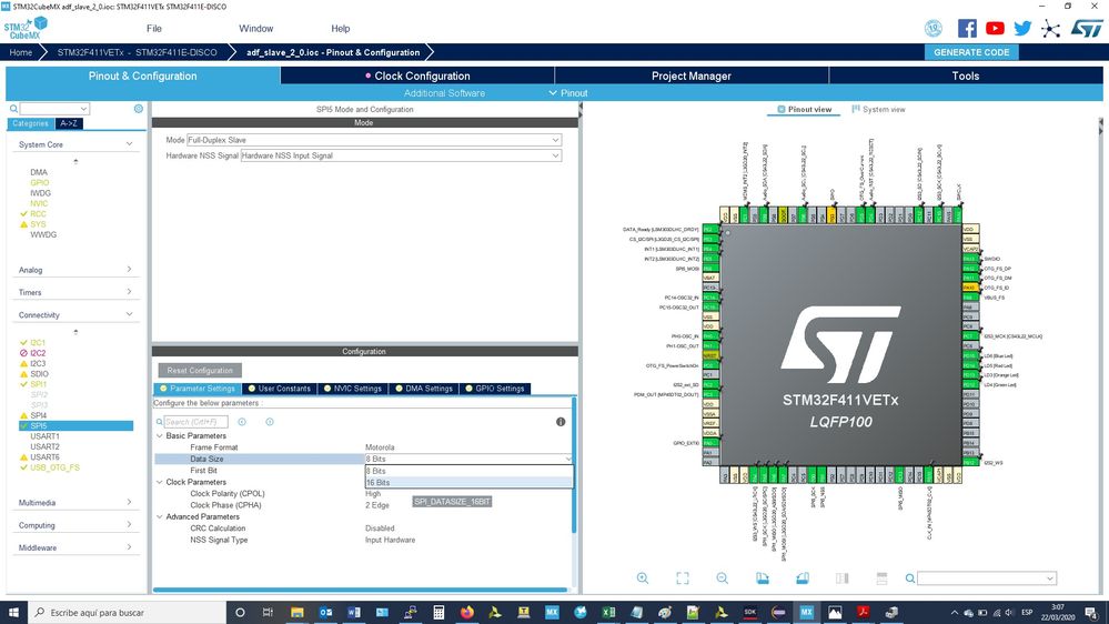

Hi, I want to receive 32 bit data from a SPI master but in the cubemx options there are only two options available, 8 bits and 16 bits, so what if I want to receive 32 bits frames, what should I do?
Thanks

You read 4 bytes, and convert those into the 32 bit value of your choice.

But how could I read 4 bytes if the cubemx only gives two options for the data size in the slave?, 8 bits and 16 bits

You set up the peripheral for 8 bits and send multiple 8-bit transactions. On the bus, these look the same as a 32-bit operation. Are you familiar with the SPI protocol?
For example, if you are trying to send 32 bits:
uint8_t data[4] = {1, 2, 3, 4};
HAL_SPI_Transmit(hspi, data, 4, SPI_TIMEOUT_MAX)
