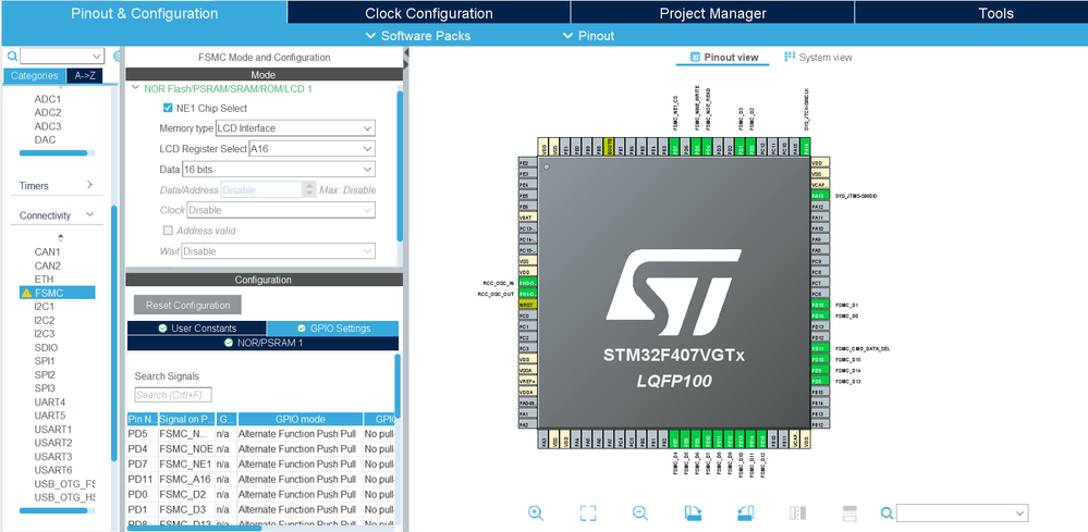

Hello all, I want to interface my STM32f407vgtx microcontroller with ILI9325 lcd and for this I have initialized FSMC as per my requirements. But to properly communicate with ILI9325 LCD , I want to read/write pins named NOE, NWE, CS , Cmd/Data .
Can we have some APIs available to do this. Please help.

yes, for command and data pins to read/write i am using 0x60000000 and 0x60010000(as i used A16 correct me if i am wrong). But unable to find any way to read/write pins like NOE,NWE,CS ..

For various reasons:
(1)To write some commands i have to forcefully set the write pin (NWE)to high while read pin(NOE) to low.
(2)To read/write data from RDR(read data register) /WDR(write data register i have set the RS register(address select).
How FSMC know that whether I want reading or writing?
i am now confused and thinking to use GPIOs instead of FSMC. Can't we have Individual addresses like in case of RS Pin for each pin so that i can change it accordingly ? Please help.
