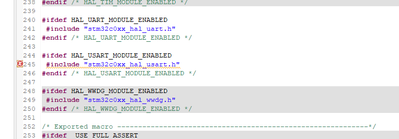

2024-02-24 2:59 AM

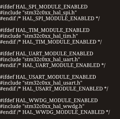

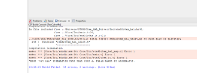

In file stm32c0xx_hal_conf_template.h there are duplicated lines at 239 row.
#ifdef HAL_UART_MODULE_ENABLED
#include "stm32c0xx_hal_uart.h"
#endif /* HAL_UART_MODULE_ENABLED */
if you are using Cube MX you can't compile.

2024-02-24 3:23 AM - edited 2024-02-24 3:24 AM
Hello @MatteoBandini74
Can you add more details on the issue. On the stm32c0xx_hal_conf_template.h, i can't see any duplicated lines:
could you add your .ioc file with some description (screenshots,...) So we can reproduce this behavior.
Best Regards.
STTwo-32
2024-02-24 4:12 AM
@MatteoBandini74 wrote:there are duplicated lines at 239 row.
To be duplicated, it must occur twice - so where is the other occurrence?
2024-02-24 6:12 AM
Probably the author mistook UART and USART for the same thing.

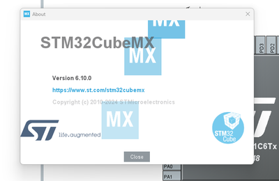

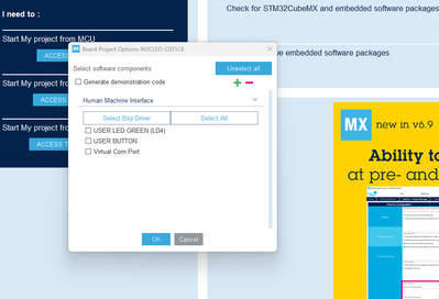

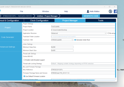

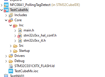

2024-02-25 1:48 AM

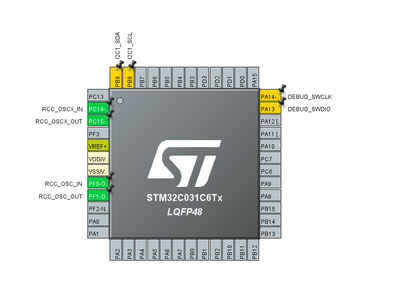

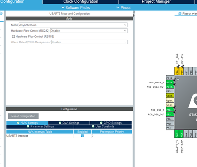

2024-02-25 2:10 AM
And if you reopen ioc file th uart disappear..
Look:
