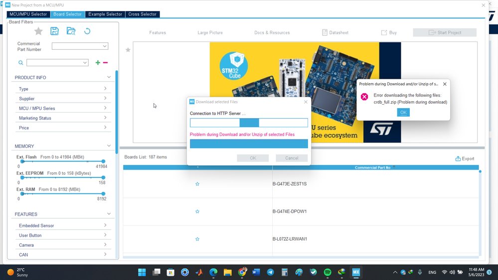

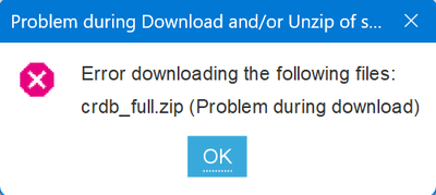

I get this error in downloading files in side stm32cubemx:
error downloading the following files: crdb_full.zip

Sorry, I am running as an administrator in version 6.11.1 of STM32CubeMX, and in Start My Project from MCU
This error still occurs when ACCESS TOMCU SELECT
