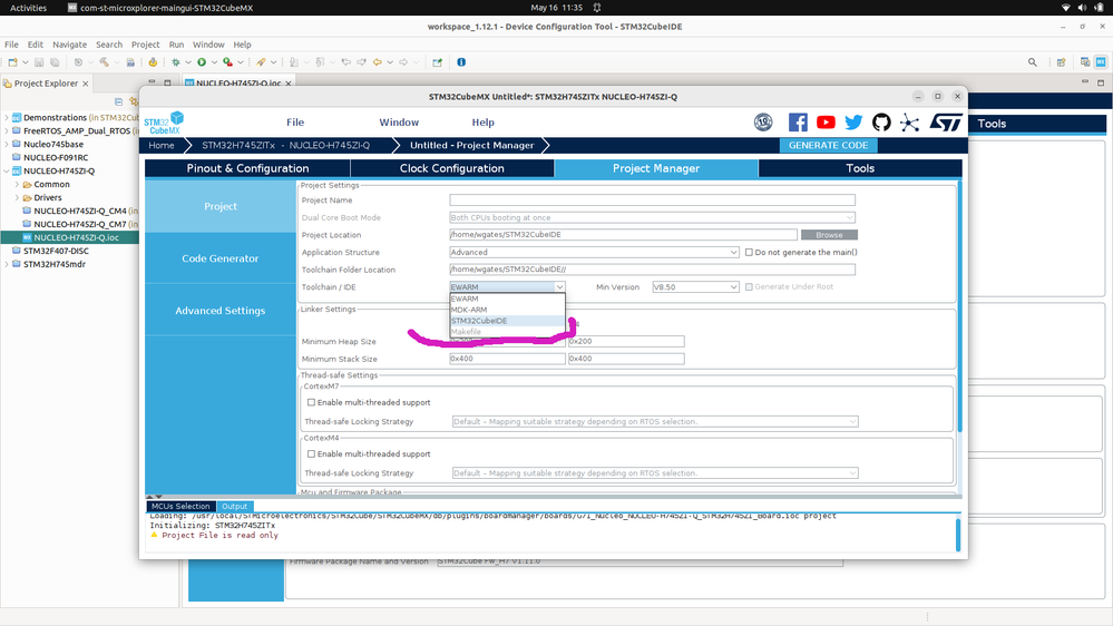

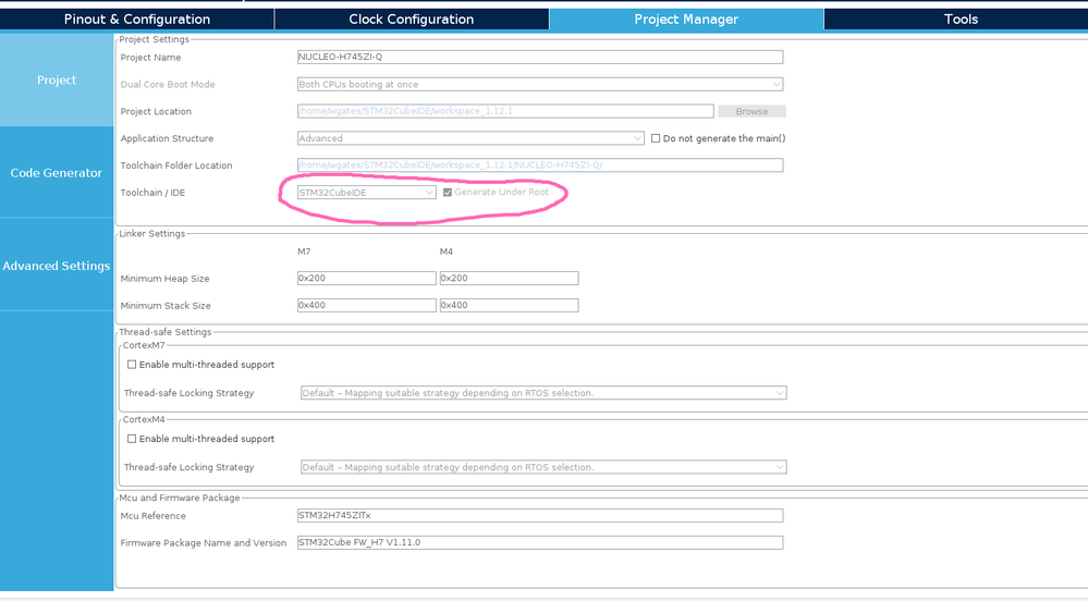

I am running STM32CubeIDE Version: 1.12.1 on Ubuntu 22.04. I am using a NUCLEO-H745ZI-Q board. Is it possible or reasonable to expect that I should be able to configure the Make tool chain using the STM32CubeIDE instead of the default STMCubeIDE tool chain? I also tried using STMCubeMX standalone but the Make options seem to be grayed out/inactive. I found AN5361 helpful for getting started but have not come across perhaps some deeper dive documents for Dual Core project setup.

I got some rumors that for STM32CubeMX standalone, this makefile project type shall be activated for dual-core devices very soon. Traditionally, STM32CubeMX is updated end of June, beginning of July...
So, stay tune !!!

What I know, makefile option is avaiable only through CubeMx as standalone, not IDE
