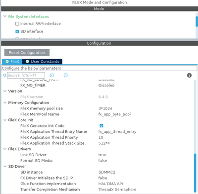

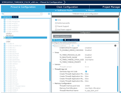

Initially, operating files in SRAM via fx_media_open only worked after increasing the default value of FX_APP_THREAD_STACK_SIZE from 512B to 4 × 512B.

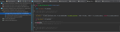

Subsequently, we switched to operations with a 16 GB SD card, maintaining the same parameters. However, the fx_media_open command fails to open the media, returning FX_BOOT_ERROR (0x01).
Observations:

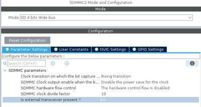

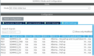

1. The presence of the SD card is correctly detected.
2. The SDMMC clock was reduced to 25 MHz.
3. On the STM32H735G-DK board, as per the official example (link), all FileX operations worked, but only with cards smaller than 64 GB (no support when formatted in exFAT).
4. STM32CubeMX, Version: 6.15.0-RC7, Build: 20250701-1659 (UTC).
5. STM32CubeIDE, Version: 1.19.0, Build: 25607_20250703_0907 (UTC).
Attached are some screenshots of CubeIDE/MX for reference.
