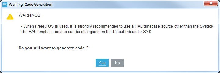

About the Systick, is a high recommendation from STMCube to use a different timebase source
"When RTOS is used, it is strongly recommended to use a HAL timebase source other than the Systick. The HAL timebase source can be changed from the Pinout tab under SYS"
Did you even read what it says? It recommends using other timer for HAL timebase, not for FreeRTOS. They do this because their flawed HAL junk uses timeouts in functions, which can be called from ISRs. Because of that HAL timebase interrupt must be set to the highest priority, but FreeRTOS's tick interrupt must not be higher than configLIBRARY_MAX_SYSCALL_INTERRUPT_PRIORITY and is recommended to be set to the lowest priority. If one doesn't use HAL junk, then all of that idiocracy is not relevant.
