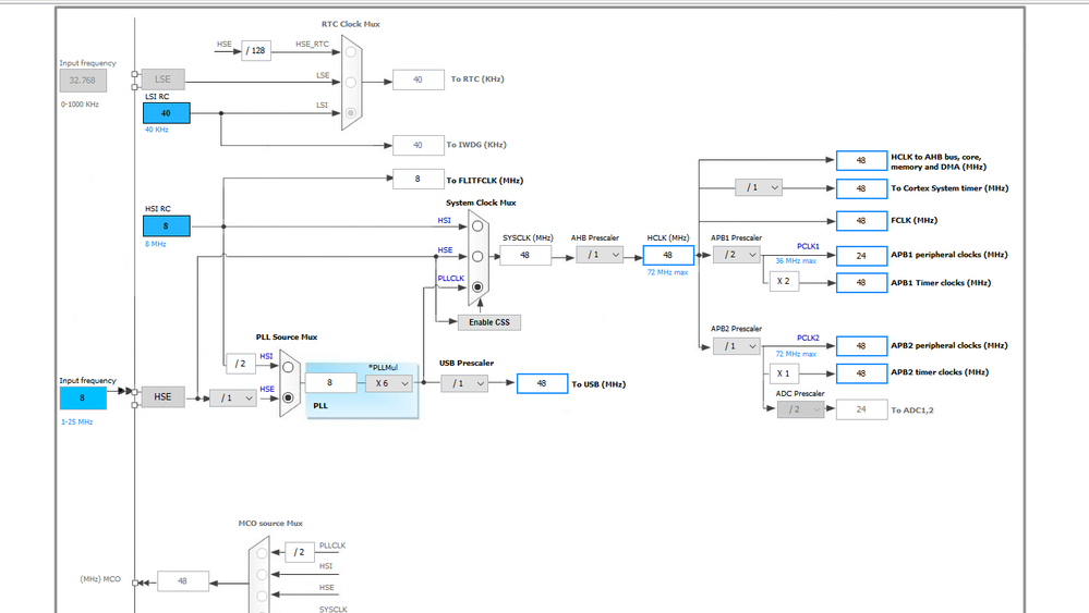

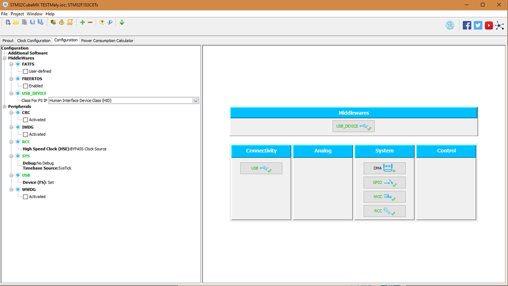

I generated project from STM32CubeMX, Device should be connected like mouse device ,but after i connected blue pill to pc, it showed error message. In device manager->state of device was error state "A request for the USB device descriptor failed."
