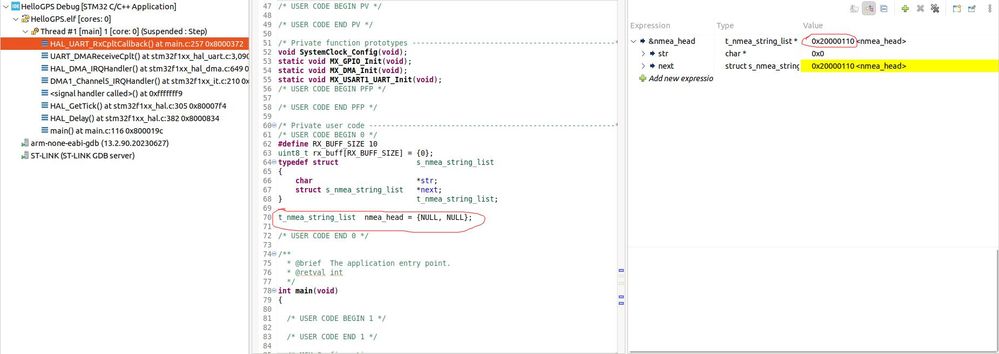

I am absolute noob with stm32 and i am currently trying to connect GY-GPS6MV2 module to RobotDyn STM32 Mini(STM32F103C8T6). I have connected GPS module to pins and set up USART1 in asyncronous mode. I have done everethyng according to official example on how to work with USART1 using DMA. In the interrupt handler i wrote small piece of code to copy data from rx buffer to linked list. But from here things have gone really weird, because in the debugger i see, that my global variable(nmea_head, this is first node in linked list) is allocated in the same memory area where irq handler stack resides(See attached screenshots). What am i doing wrong?

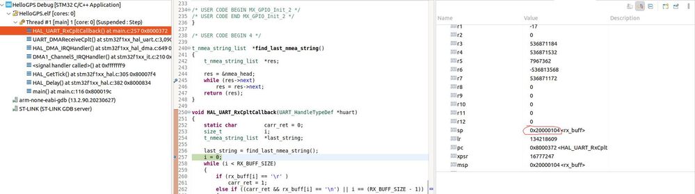

Here you can see, that SP for HAL_UART_RxCpltCallback is at 0x20000104
This is definition of global variable nmea_head. On the right side you can see, that it was placed on the address 0x20000110. This address overlaps with stack frame of HAL_UART_RxCpltCallback, so my variable gets corrupted. What am i doing wrong?
This happens prior to any calls to malloc or free, and i am not accessing this variable from anywhere else, so there should not be any race conditions.

Do you have larger local variables occupying the stack? If you click through the call stack (left), you can check this and by looking at the value of sp in various depths of the call/exception hierarchy. Expected behaviour: the initial (downmost) sp is close to the top of the SRAM and decreases only mildly from stage to stage.
