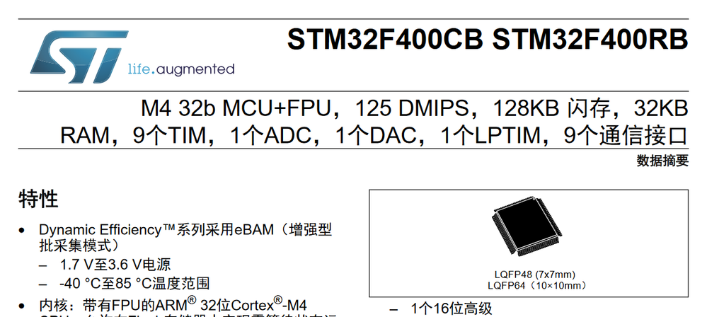

2022-09-27 12:43 PM
2022-09-27 1:03 PM
Seems like a Chinese market device lacking QSPI, CRYP, USB, CAN and ETHERNET IP and limited memory.
Might be a subset of the F41x, I'd imagine there are HAL, or libraries available to the primary customers of this device.
Perhaps probe it a little?
Query the DEV_ID ? Look at the ROM code ?
Cross reference data sheet information with others, and reference manuals
https://datasheet.lcsc.com/lcsc/2204211700_STMicroelectronics-STM32F400RBT6_C2965704.pdf
