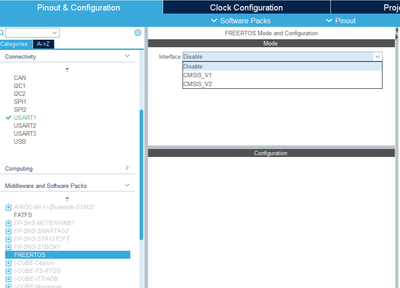

It's a disaster that Current CubeMX have to select CMSIS when enabling freertos. many developers use raw freertos API to develop project. The project based on raw freertos api is more compatiable with other MCUs, also they are familar with raw freertos API. I think this option should be reserved for developer.
Is there any way to use raw freertos api in cubemx?
