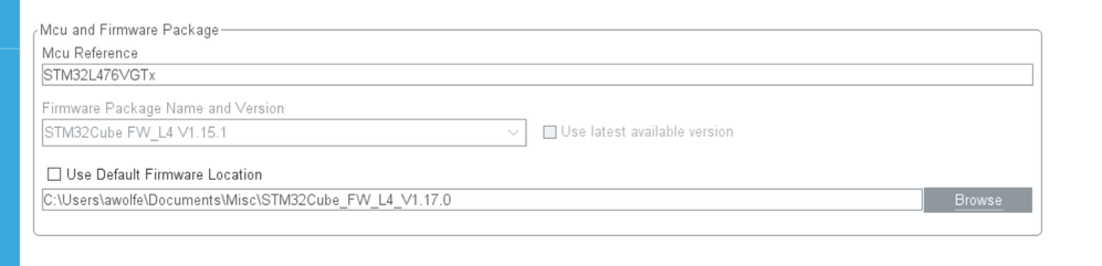

The real problem is that is I use the Project Manager to select an alternate path, then I save the project; the alternate path does not get saved and it is not there when I reopen the project. The alternate path is used before I save the file. That must be a bug, right?
I set the path like this and it works:

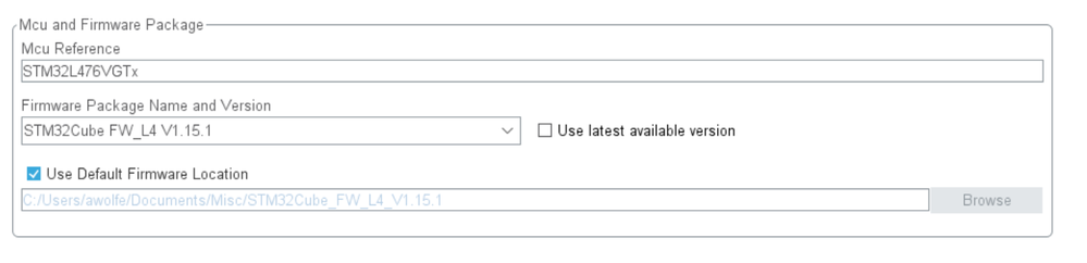

Then I save, close, and open the project and I get:
2022-04-06 10:37 AM
Hmm, somehow it looks as if the path is still included, but the check mark for "User Default Firmware Location" has been set again. As a workaround, deleting the check mark manually should therefore work.
Which version of CubeMX are you using?
Regards
/Peter
