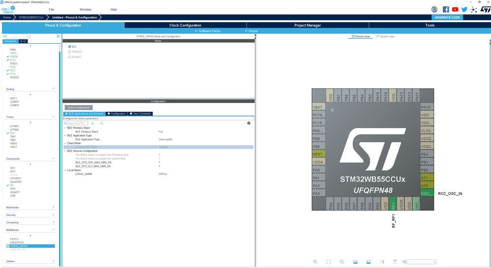

I have to configure it as a Client. Can please someone help me with the starting guide for the client configuration like how to establish connection with server and how to write attribute to server, everywhere I found only starting guide for server only.
Thank You,
Arief

To configure the STM32WB55 as a BLE client using the CubeMX software, you'll need to perform the following steps:
The process for establishing a connection with a BLE server using a BLE wireless stack will depend on the specific stack you are using, but in general, you will need to perform the following steps:

Hello @Community member
