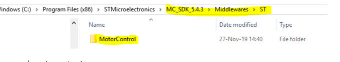

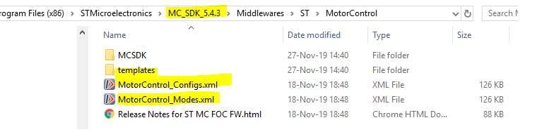

Please try with this steps:
You already need a well-named directory in the STM32Cube repository :
Generally speaking: MCSDK_vX.Y.Z..
In this directory, you will have to copy the MotorControl directory found in the MCSDK installation:
and have the following content in the tree structure:

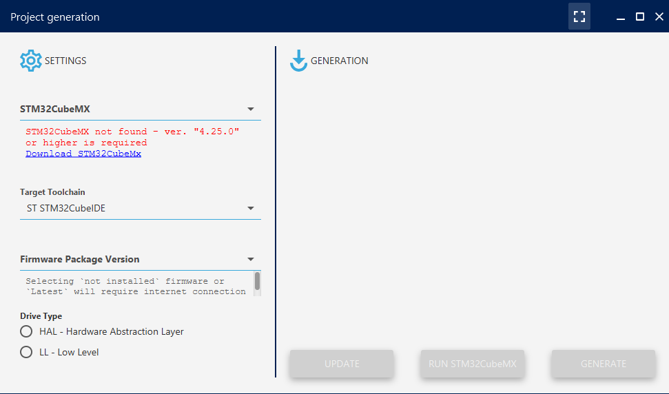

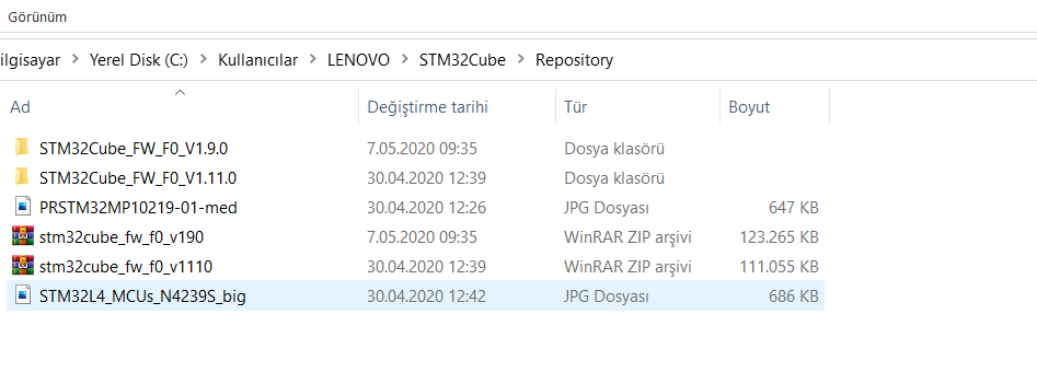

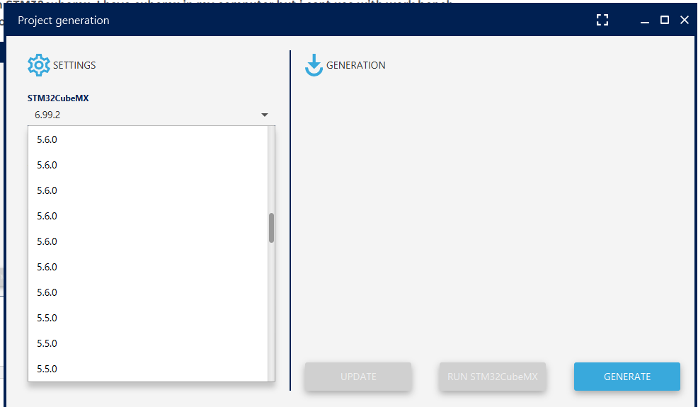

Hi @Nesrine.JLASSI , First of all thank you for attention. I am using CubeMx version 5.6. And i tried this steps but probably i have problem about XML file.
2020-05-07 2:52 AM

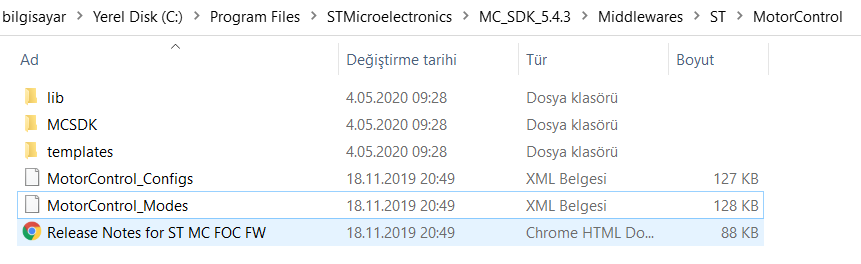

And I dont have MCSDKv5.4.3 file in repository file.
2020-05-07 3:23 PM
As nesrine already stated: You NEED that directory (as described), then you have to copy the MotorControl directory found in the MCSDK installation. Inside you should have the described content then… Read the instructions again (and carefully ;) )
2020-05-08 2:02 AM
Thank you for attention i fixed my problem. My problem derives from the my computer language. When i changed my computer language Turkish to English problem solved to. ;)
