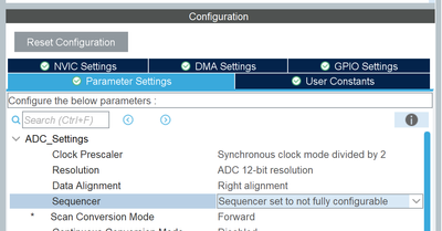

2024-03-11 6:17 AM
> Now my question, how can i setup a DMA multichannel ADC conversion for 10 channel without reprogramming Channel and Rank before each conversion ?
Set the sequencer to Not fully configurable. In that mode, all channels will be converted in order (forward) or in reverse order (backward) depending on how scan conversion mode is set.
2024-03-11 6:17 AM

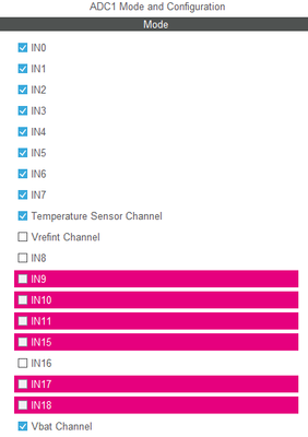

2024-03-13 8:41 AM
Hi TDK,
thanks for your answer, it works.
I have chosen 10 channel with the above Sequencer setting
and all 10 (marked) channel are measured one after another.
That means the VBAT channel data will be stored in the dma array buffer with index 9.
