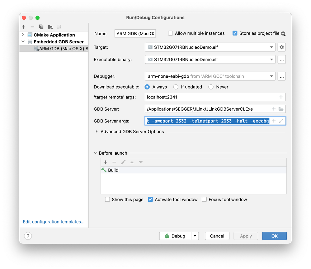

2025-02-25 7:52 AM
Excellent contribution. I have a similar setup, works like a charm. CLion accelerates my production at least 4-5x and diminishes faulty SW considerably. Worth every € I paid for it.
For those interested, I use SEGGER's J-Link instead of OCD. This is the setup for using it with CLion/GDB:
