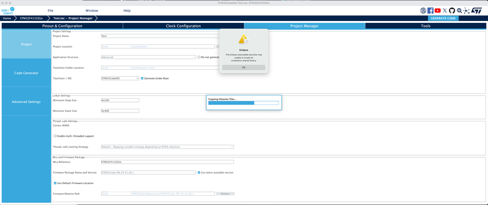

I’m new to STM32 development and need some help configuring CLion for working with STM32 microcontrollers. I have installed STM32CubeMX (version 6.13.0) and am trying to generate a project for my STM32F411CEU6 microcontroller. However, I’m encountering an issue where the Eclipse launcher fails to work, and I can’t proceed further.
I’m using macOS Sequoia (version 15.2). Could anyone guide me through the process of setting up CLion on macOS to work with STM32?

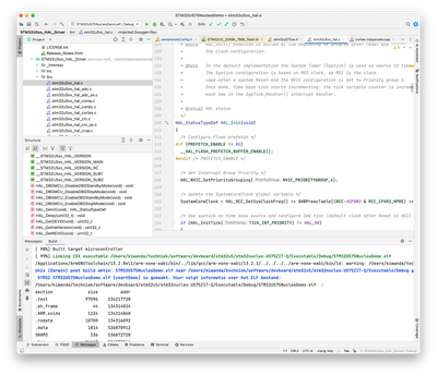

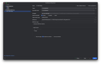

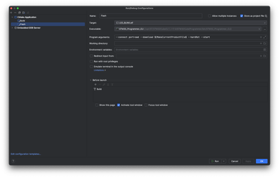

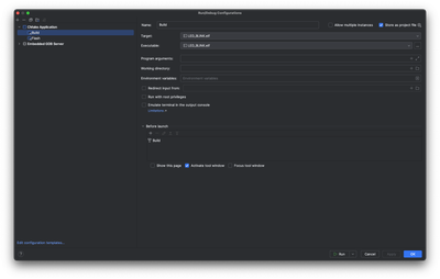

By the way, if anyone finds it useful, I’m sharing my CLion setup for STM32 development on macOS (Apple Silicon)
To get started, you’ll need to install STM32CubeCLT, which will automatically set up the required toolchain in the /opt/ directory on your Mac.
Here are screenshots of my three configurations:
Build setup
Flashing the STM32
Debugging setup
