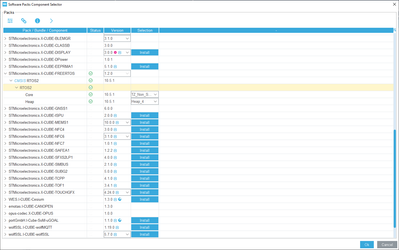

I've been following the available resources online, but I am encountering issues. Specifically, I can't find the FreeRTOS option under the Pinout & Configuration tab -> Categories. I can see the X-CUBE-FREERTOS option, but I am unable to enable it. I have attached a screenshot of the issue I am facing.

If you click on the "X-CUBE-FREERTOS" the "Software Packs Component Selector" will be opened.
Install the pack if it's not already installed then activate it:

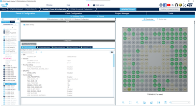

Then you can configure the FreeRtos MW:

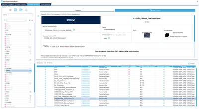

For the Octo SPI example check the example selector:
