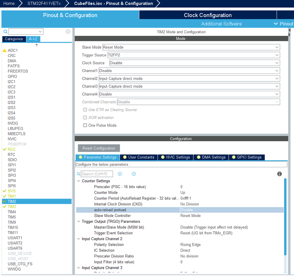

I am using an RC transmitter to send signals to a receiver that is hooked up to an STM32F411VE board. I am reading the receiver signal using input capture direct mode (timer 2, channel 2). I am reading a consistent range of values. It works, and I am able to calculate an angle which steers a servo. All good up until this point.

Here is my config for Timer 2:

Perhaps running using the debugger/IDE is initializing some clock circuitry differently than from a hard reset. The debugger startup script may be setting something that your code doesn't. If you have a debug port, add code to output the clock configuration registers after you call HAL_Init() and see if they match from the IDE and from a hard reset or power-on.
Or the reset vector in the interrupt vector table isn't correct. Debugging with the IDE usually doesn't actually use the reset address in the vector table. It uses the "start" address from the ELF file.
