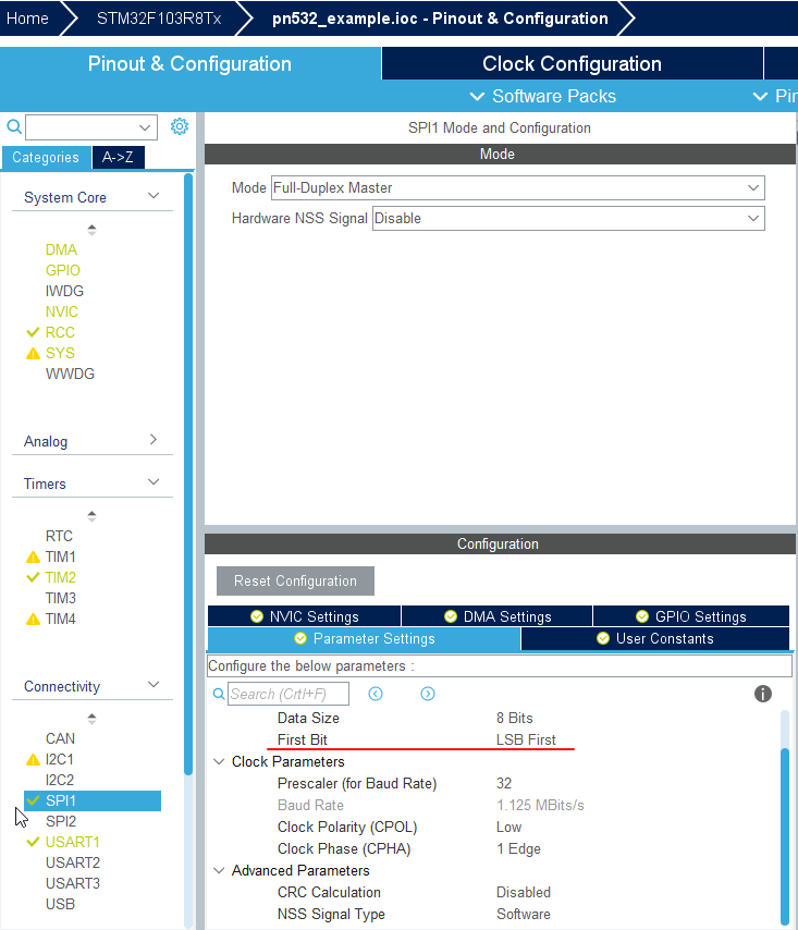

I setup SPI using CubeMX and set First Bit as LSB First as described in the datasheet.
I thought setting this will handle LSB data by itself however it is not working as expected.
Below code only work with _SPI_HARDWARE_LSB defined which means I have to manually realign all the data in the buffer when transmitting through HAL_SPI function.
Is this is known issue or is how LSB suppose to be handled?

The hardware probably works. Put together a simpler example that strips possibly faulty logic from your program. Verify that SPIx_CR1_LSBFIRST is as expected.
