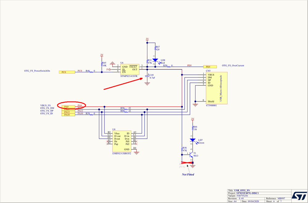

If a pin on a Disco/Nucleo/Eval does not work as you expect, check the manual/schematics where is that pin connected.
In this particular case, disconnect C49.
