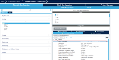

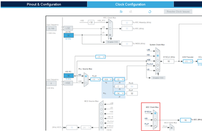

Despite enabling ADC, the ADC clock option is greyed out for MCU STM32G0B1KBUx. I'm using version 6.16.1

Hello @G5658 ,
Under ADC Settings, you need to set the clock prescaler to: Asynchronous clock mode.
Thanks.

2026-01-06 11:51 PM
Hello @G5658 ,
Thanks.
Mahmoud
