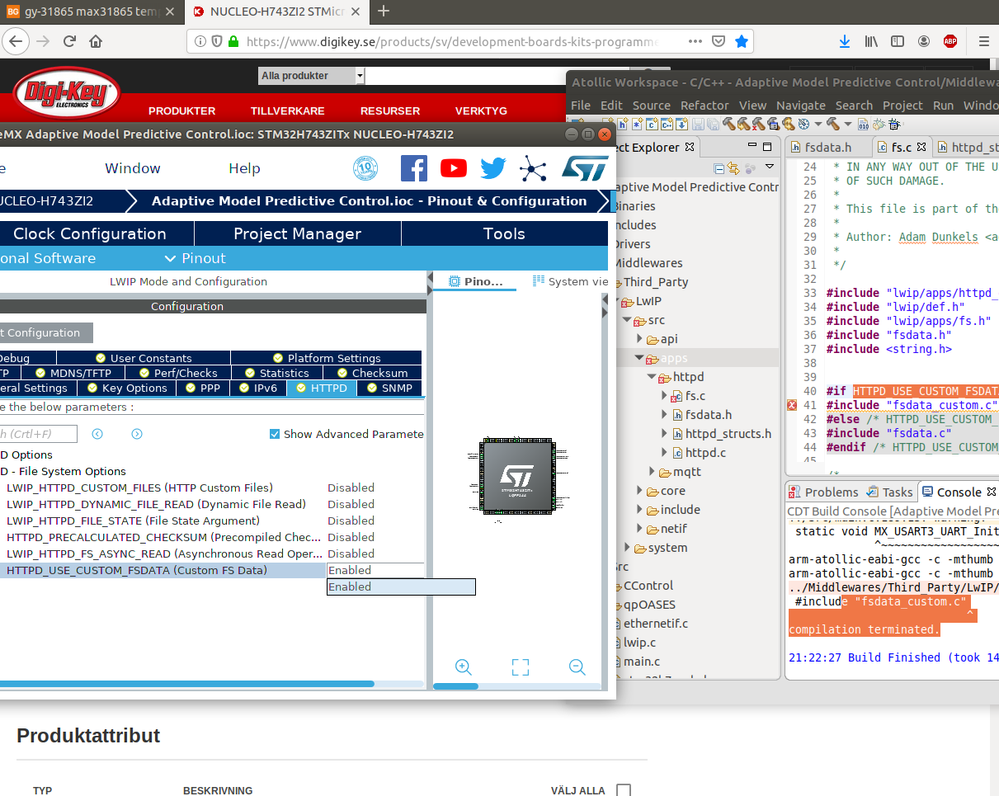

I trying to follow this manual to set upp a HTTPD web server in STM32 Nucleo H7 board. But I got a issue because fsdata_custom.c is missing and it seems that I cannot set HTTPD_USE_CUSTOM_FSDATA to false neither. Is this a bug in CubeMX?
How can I solve it? I posted a screen shot and it will give you all the information about my board I'm using.
2019-10-26 2:51 PM
See p.8 about the fsdata.c file.
2019-10-27 4:57 AM
That's about file fsdata.c, not fsdata_custom.c
2019-10-27 6:48 AM
Just change the filename in either place.

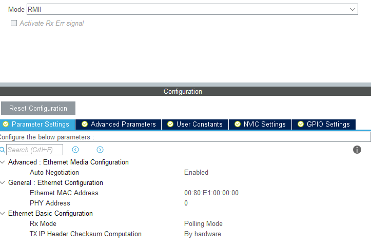

My settings for the ETH are:
Nothing change for the PHY settings (default LAN8742a) and the interrupts are enabled. GPIOs are double checked.

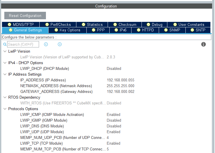

My settings for the LwIP are:And here is my main:
