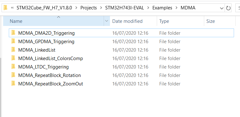

Hello @CMA
This examples (under this link) can help you:
C:\Users\nesrine jlassi\STM32Cube\Repository\STM32Cube_FW_H7_V1.8.0\Projects\STM32H743I-EVAL\Examples\MDMA Best regards,
Nesrine
