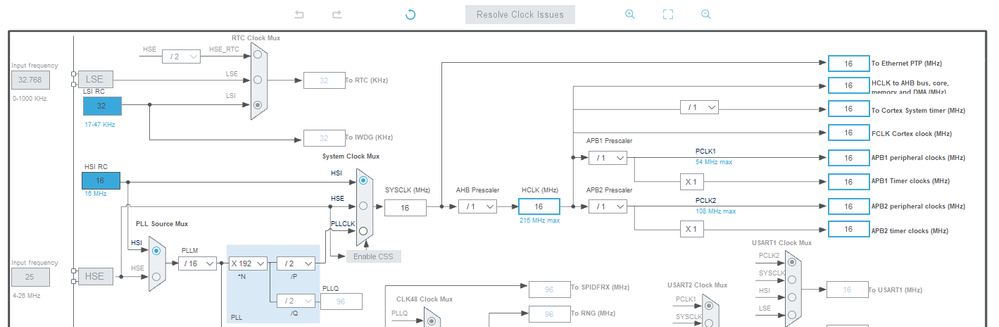

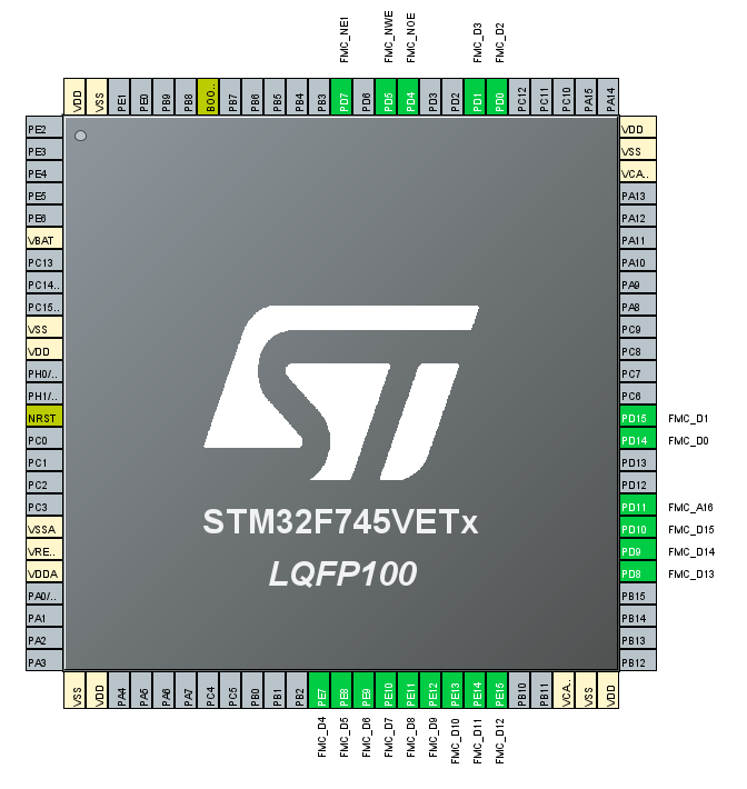

2) I make another STM32CubeMX project for STM32F745VET. and I add options for FMC like below.
And I generated code for STM32CubeIDE.
3) I compiled project, and flashed on my custom PCB which has STM32F745VET.
and while debugging, always It hangs at FMC_NORSRAM_Init() in the HAL_SRAM_Init. It alway falls into MemManage_Hander().

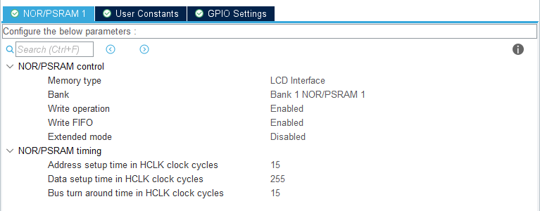

4) But when I select options like below, FMC works and I can see NOE, NWE pin signal moves.
I don't know why SRAM options does not work on STM32F745VET.
