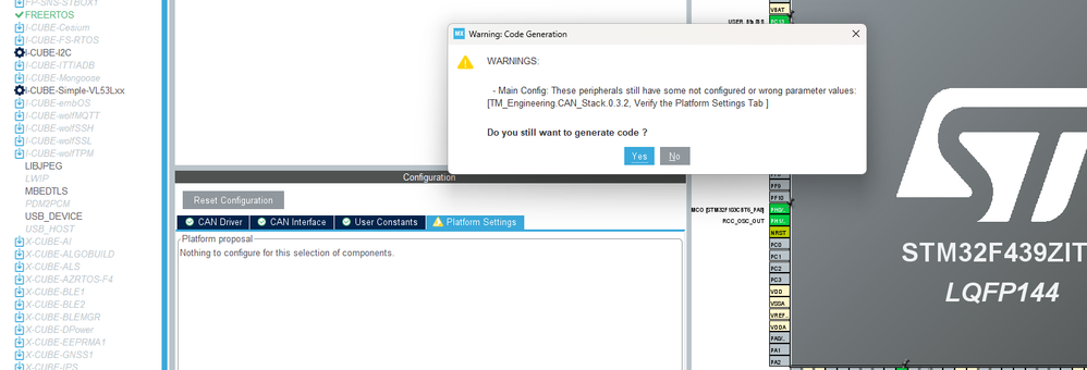

I made a support pack for better support of CAN connections.
But there is no possibility to create a "Platform Setting" for CAN connections
I tried to edit the "Modes.xml" manually. Than the PackCreator shows the correct IP, but STM32CubeMX doesn't accept it.
Additional: if I create a not usable platform setting there will be "unsovlable" warning.

Hello @TManiac
Your change request has been escalated to dev team under internal ticket ID:226187 for feasibility check.
THX
Ghofrane
