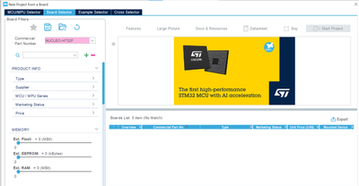

Generating configuration code for NUCLEO-H732FX which includes MEMS. In app_mems.c the generated code appears to attempt initializing the virtual COM out with an incorrectly formed call:
/* Initialize Virtual COM Port */
BSP_COM_Init(COM1);returning:

Hello @TheMentat
Are you sure about the board part number "NUCLEO-H732FX" ?
I would appreciate it if you could provide your IOC
I will be waiting for your feedback.
