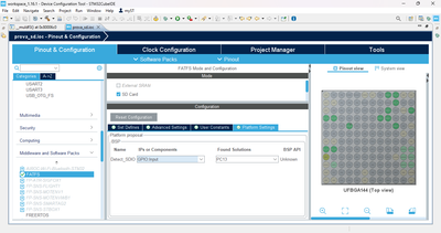

the configuration on cubeMX is the following:

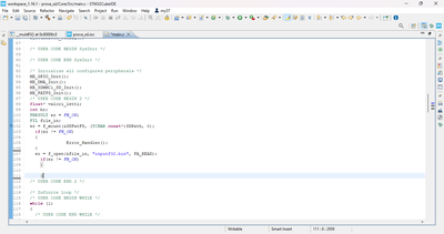

On stmcubeIDE in main project I only entered the function f_mount and f_open:
with the debugger I saw that f_open returns me FR_NOT_READY.
