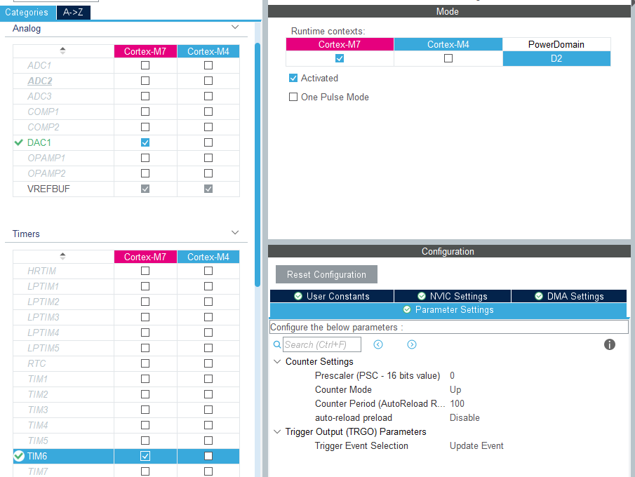

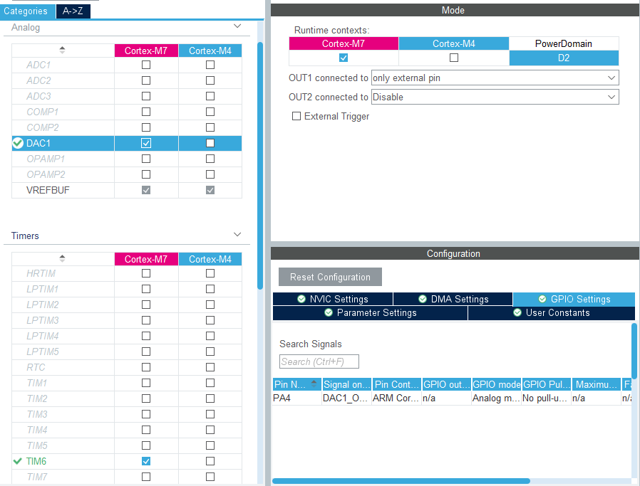

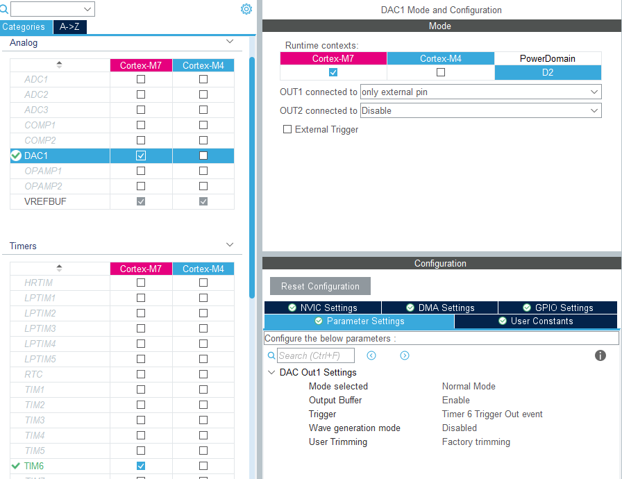

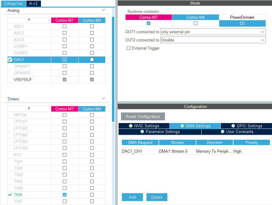

I followed a tutorial on how to generate a SINE wave using DAC and DMA that was really good. Logically it makes sense, you set up the DAC, set it to be triggered by a timer, then set up the DMA channel, set it to circular, and set it to use a table of values. Start the time and the DAC DMA, should work, right? Not working for me unfortunately, no output on the PIN PA4. Here are some screenshots of my CubeMX and a snippet of my MAIN Code:
/* USER CODE BEGIN 0 */
#define NS 128
uint32_t Wave_LUT[NS] = {
2048, 2149, 2250, 2350, 2450, 2549, 2646, 2742, 2837, 2929, 3020, 3108, 3193, 3275, 3355,
3431, 3504, 3574, 3639, 3701, 3759, 3812, 3861, 3906, 3946, 3982, 4013, 4039, 4060, 4076,
4087, 4094, 4095, 4091, 4082, 4069, 4050, 4026, 3998, 3965, 3927, 3884, 3837, 3786, 3730,
3671, 3607, 3539, 3468, 3394, 3316, 3235, 3151, 3064, 2975, 2883, 2790, 2695, 2598, 2500,
2400, 2300, 2199, 2098, 1997, 1896, 1795, 1695, 1595, 1497, 1400, 1305, 1212, 1120, 1031,
944, 860, 779, 701, 627, 556, 488, 424, 365, 309, 258, 211, 168, 130, 97,
69, 45, 26, 13, 4, 0, 1, 8, 19, 35, 56, 82, 113, 149, 189,
234, 283, 336, 394, 456, 521, 591, 664, 740, 820, 902, 987, 1075, 1166, 1258,
1353, 1449, 1546, 1645, 1745, 1845, 1946, 2047
/* USER CODE END 0 */
* @retval int
int main(void)
/* USER CODE BEGIN 1 */
HAL_DAC_Start_DMA(&hdac, DAC_CHANNEL_1, (uint32_t*)Wave_LUT, 128, DAC_ALIGN_12B_R);
HAL_TIM_Base_Start(&htim2);
/* USER CODE END 1 */
Any help / thoughts are appreciated!

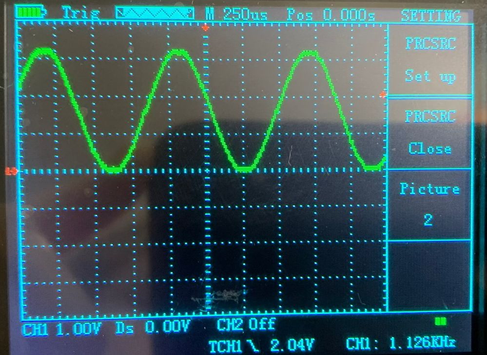

Thanks TDK and Georgy! I appreciate the detailed answer about DMA memory, I will keep the CONST in mind for the future.
Turns out it was where I put my DMA transfer start call. Putting it in USER CODE BEGIN 2 did it. Can't believe that I missed that. Thanks so much! Here is the beautiful end result:
2021-09-30 3:26 AM
That was it, thanks again!

I have a follow-up question, which almost identical: I have not used any of the STM32 products, so I am quite struggling with that beast of a STM32H747, which is integrated into an STM32-based Riverdi display. I have managed so far to output single DC-values up to Vref using the DAC, but I have completely failed to make the DMA work, despite a number of examples on the internet. I cannot get my head around the datasheet, which seems to suggest that there are specific (hardware-wired) DMA channels for the DAC, but in practice, one can only work with "streams". So it seems that any of the streams can be selected and the concept of a DMA channel does not exist for the H7. I am mentioning this as some tutorials suggest that certain STM32FXX MCUs seem to require certain DMA channel numbers. But assuming that I can set up the DMA with the GUI MX tool .ioc without being an expert on the MCU's architecture I have is still a problem getting any voltage at the PA4 output. Please find the main.c code and screen-shots below. I am getting desperate here as I almost considering using the other M4 core to spit out the waveform in an endless loop, so any help is highly appreciated!
