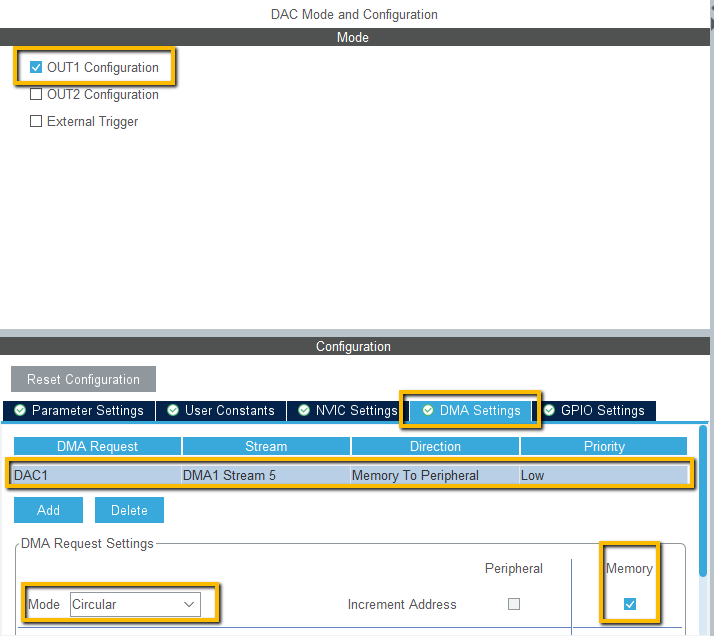

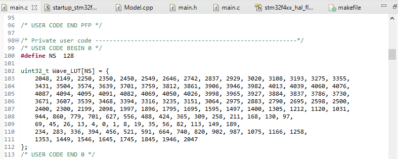

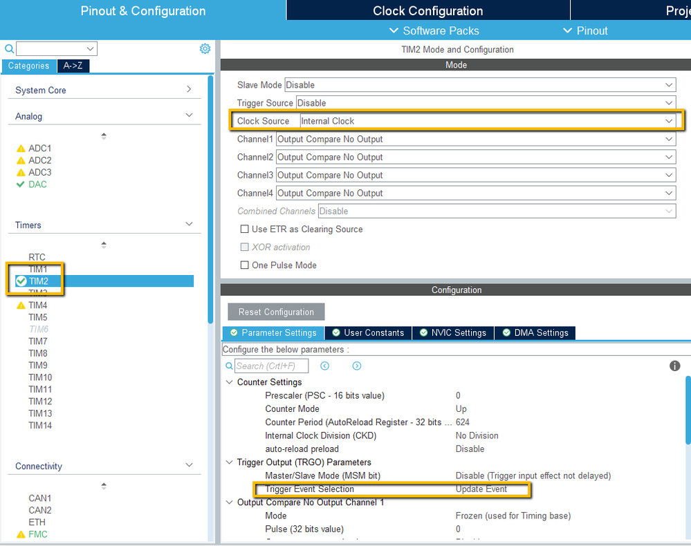

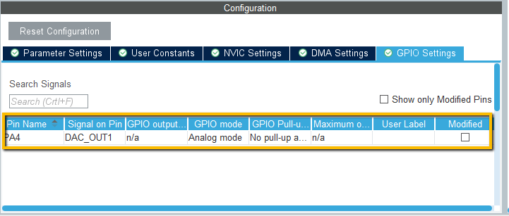

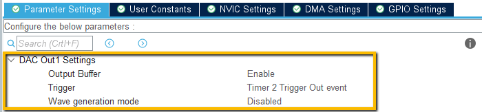

I followed a tutorial on how to generate a SINE wave using DAC and DMA that was really good. Logically it makes sense, you set up the DAC, set it to be triggered by a timer, then set up the DMA channel, set it to circular, and set it to use a table of values. Start the time and the DAC DMA, should work, right? Not working for me unfortunately, no output on the PIN PA4. Here are some screenshots of my CubeMX and a snippet of my MAIN Code:
/* USER CODE BEGIN 0 */
#define NS 128
uint32_t Wave_LUT[NS] = {
2048, 2149, 2250, 2350, 2450, 2549, 2646, 2742, 2837, 2929, 3020, 3108, 3193, 3275, 3355,
3431, 3504, 3574, 3639, 3701, 3759, 3812, 3861, 3906, 3946, 3982, 4013, 4039, 4060, 4076,
4087, 4094, 4095, 4091, 4082, 4069, 4050, 4026, 3998, 3965, 3927, 3884, 3837, 3786, 3730,
3671, 3607, 3539, 3468, 3394, 3316, 3235, 3151, 3064, 2975, 2883, 2790, 2695, 2598, 2500,
2400, 2300, 2199, 2098, 1997, 1896, 1795, 1695, 1595, 1497, 1400, 1305, 1212, 1120, 1031,
944, 860, 779, 701, 627, 556, 488, 424, 365, 309, 258, 211, 168, 130, 97,
69, 45, 26, 13, 4, 0, 1, 8, 19, 35, 56, 82, 113, 149, 189,
234, 283, 336, 394, 456, 521, 591, 664, 740, 820, 902, 987, 1075, 1166, 1258,
1353, 1449, 1546, 1645, 1745, 1845, 1946, 2047

2021-09-28 5:45 AM
Where are your initialization calls for TIM and DAC?
Does DAC work without DMA?
Is the array stored in a DMA-accessible region?
Do all HAL functions return HAL_OK?
Always include your chip number in your post.

2021-09-28 10:19 PM
On some parts variables are placed in memory which does not have DMA access. What is your MCU model? Check STM..._FLASH.ld file in project files tree to see memory addresses configuration.

Here is what I see in my Build Analyzer:
Does this look like the variable is loaded into DMA accessible RAM, or do you need more information?

static void MX_DAC_Init(void)
/* USER CODE BEGIN DAC_Init 0 */
/* USER CODE END DAC_Init 0 */
DAC_ChannelConfTypeDef sConfig = {0};
/* USER CODE BEGIN DAC_Init 1 */
/* USER CODE END DAC_Init 1 */
/** DAC Initialization
hdac.Instance = DAC;
if (HAL_DAC_Init(&hdac) != HAL_OK)
Error_Handler();
/** DAC channel OUT1 config
sConfig.DAC_Trigger = DAC_TRIGGER_T2_TRGO;
sConfig.DAC_OutputBuffer = DAC_OUTPUTBUFFER_ENABLE;
if (HAL_DAC_ConfigChannel(&hdac, &sConfig, DAC_CHANNEL_1) != HAL_OK)
Error_Handler();
/* USER CODE BEGIN DAC_Init 2 */
/* USER CODE END DAC_Init 2 */

static void MX_TIM2_Init(void)
/* USER CODE BEGIN TIM2_Init 0 */
/* USER CODE END TIM2_Init 0 */
TIM_ClockConfigTypeDef sClockSourceConfig = {0};
TIM_MasterConfigTypeDef sMasterConfig = {0};
TIM_OC_InitTypeDef sConfigOC = {0};
/* USER CODE BEGIN TIM2_Init 1 */
/* USER CODE END TIM2_Init 1 */
htim2.Instance = TIM2;
htim2.Init.Prescaler = 0;
htim2.Init.CounterMode = TIM_COUNTERMODE_UP;
htim2.Init.Period = 624;
htim2.Init.ClockDivision = TIM_CLOCKDIVISION_DIV1;
htim2.Init.AutoReloadPreload = TIM_AUTORELOAD_PRELOAD_DISABLE;
if (HAL_TIM_Base_Init(&htim2) != HAL_OK)
Error_Handler();
sClockSourceConfig.ClockSource = TIM_CLOCKSOURCE_INTERNAL;
if (HAL_TIM_ConfigClockSource(&htim2, &sClockSourceConfig) != HAL_OK)
Error_Handler();
if (HAL_TIM_OC_Init(&htim2) != HAL_OK)
Error_Handler();
sMasterConfig.MasterOutputTrigger = TIM_TRGO_UPDATE;

> Please see my reply to Georgy below, let me know if I am missing the mark on this. But from what I can tell, it's in RAM, so I think so.
Is it in RAM or in CCMRAM? The latter is not accessible by DMA. Your info below doesn't provide enough information to locate it. Attach your linker file, or debug and see the address where the array is located.
If the array isn't changing, you make it constant and it will be located in FLASH and can work that way.
