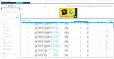

Also, I think the available USART examples compatible with STM32CubeMx can help you.
