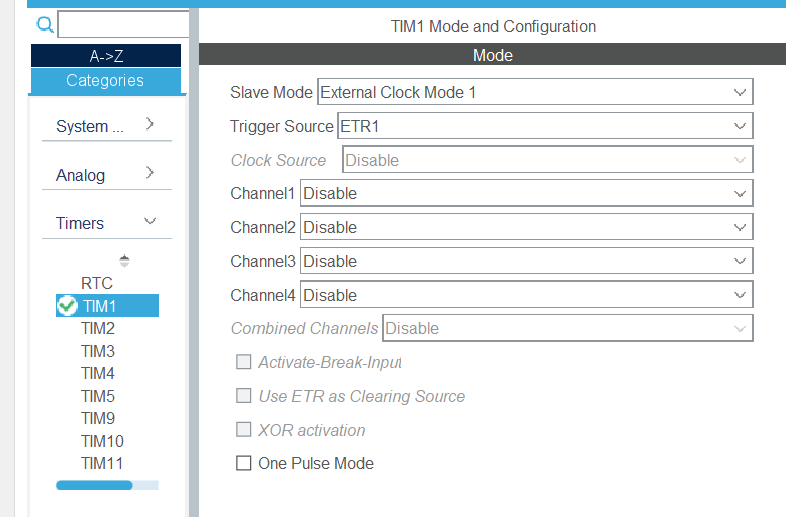

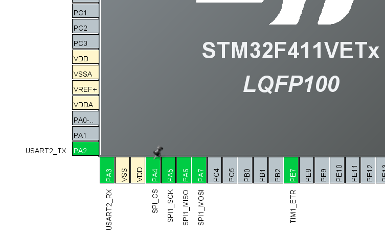

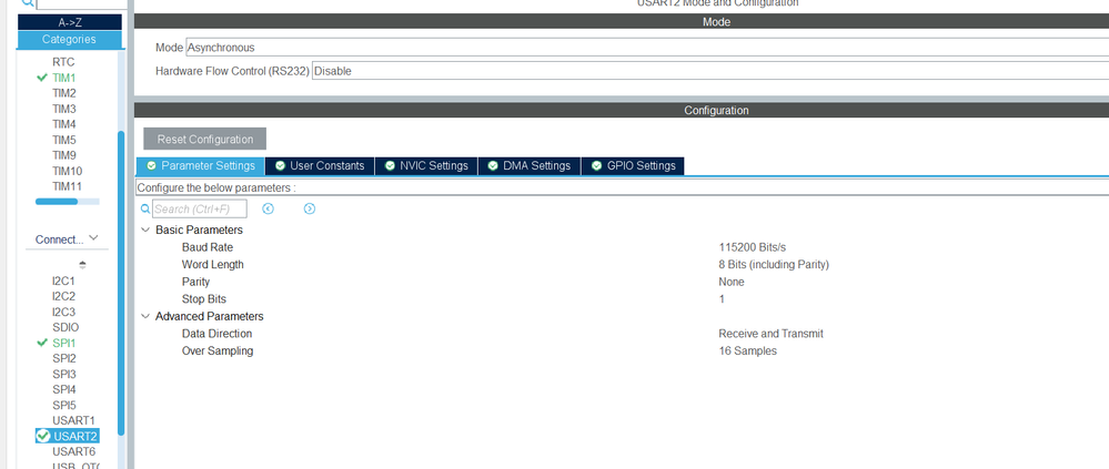

Here is the pinout view of the project

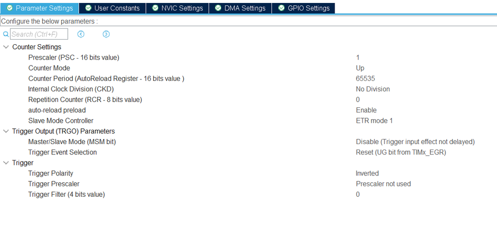

Timer1 Conig.
USART1 Config.
Code Snippets

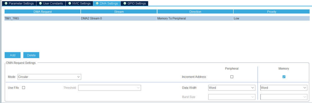

HAL_DMA_Start(&hdma_tim1_trig, (uint32_t)dma_TxBuffer, (uint32_t)&huart2.Instance->DR, BUFF_SIZE);After debugging the code I found that the DMA register does not move the data at all

I don't use Cube/CubeMX, but it appears that you have set the slave-mode controller to clock the timer from the ETR pin. This will not generate Trigger events in the timer.
But ou don't need the Trigger events at all. Connect the external signal to some timer channel pin, set that channel to Input Capture, and set DMA to be triggered from the Capture event (TIMx_DIER.CCxDE).

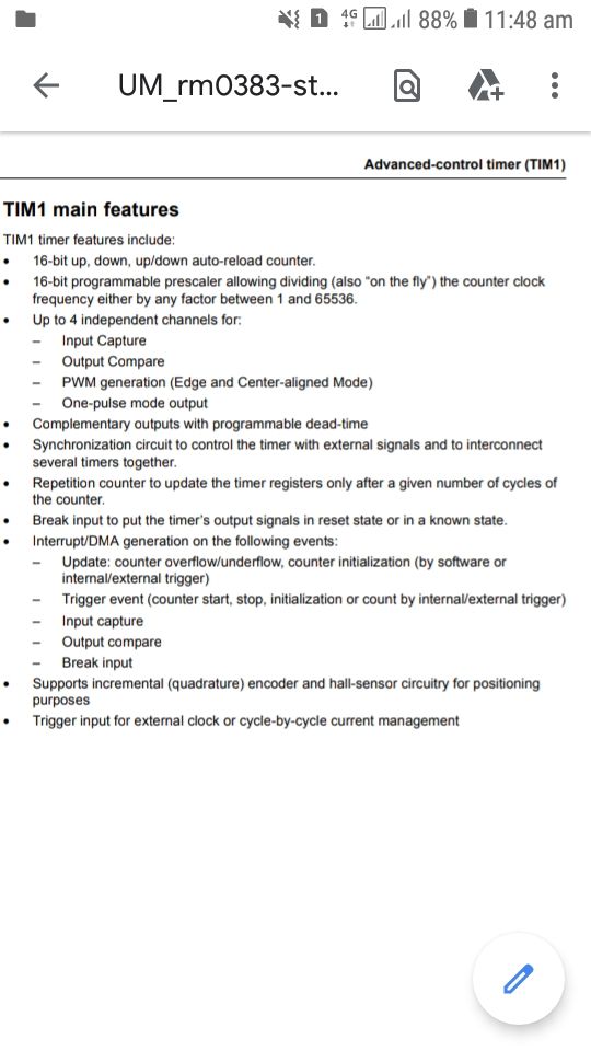

I looked up the Timer1 section in the reference manual and a dma trigger event can be generated from external trigger
2022-07-16 2:57 AM
Yes it can, but then you have to set up the Slave-mode controller to be in Trigger mode.
Read out and check TIMx_SMCR to see.

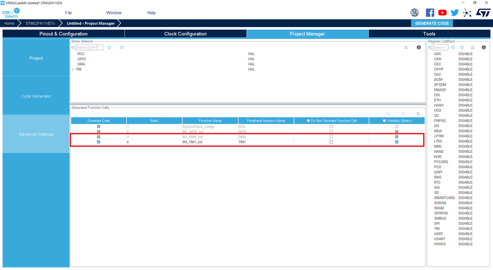

Please check the DMA inti order in Project Manager-> Advanced Settings, it has to be called before TIM1 init call (please refer to the attached screenshot )
If you are using CubeMX v6.5.0 or lower and in case the DMA init is called after the TIM inti, you need to apply the Workaround mentioned in this thread MX_DMA_Init order in the main.c file generated by STM32CubeMX, How to fix?

2022-07-22 9:04 AM
I checked, but the init is done in it's right stages
