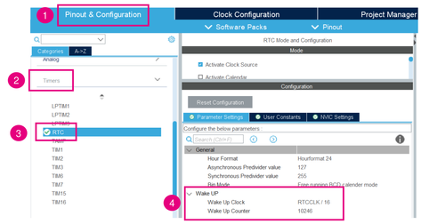

I used STM32CubeMX to generate code for the STM32U083 following the instructions in Lab 3 of the STM32U0 Workshop presentation (V2.3, last modified Fri 12 Jul 2024 09:51:37 AM ). One of the steps in the lab is to set the RTC configuration on page 102.
Upon code generation, this value appears at the end of MX_RTC_Init() in the following code snippet:

Second question: I repeated the same process on a NUCLEO-L452RE-P but, for some reason, the Wake Up Counter value entry in the CubeMX's RTC Configuration Parameter Settings seems to be ignored (i.e. the call to HAL_RTCEx_SetWakeUpTimer_IT() in MX_RTC_Init() isn't present in the L4x generated code.) Is there a particular reason for this?
