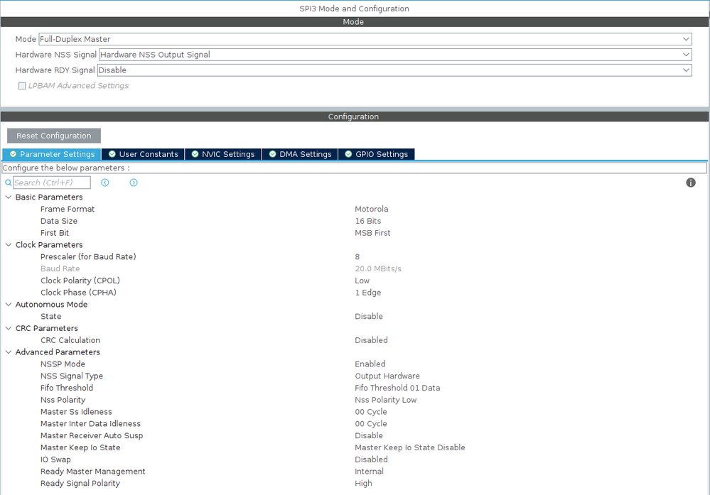

SPI Configuration:

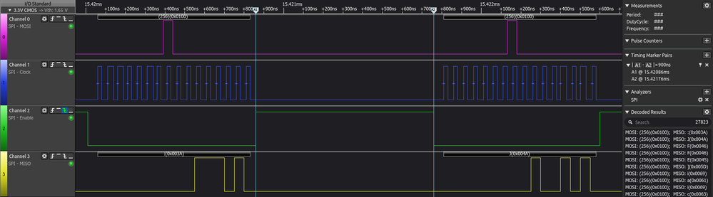

SPIM3_UNINIT();The problem is that I am seeing a large period of inactivity between transfers (about 900 ns), as shown in this logic analyzer trace:
In ideal conditions, I should be able to get the desired throughput with 20 MHz SPI. 2 bytes at 20 MHz take 800 ns to transfer, plus the 154 ns pulse --> 954 ns. Multiply by 34 bytes means I should be able to get this done in about 32 us, meeting my 50 us deadline. Actually, I should be able to get away with up to 670 ns delay between 2-byte transfers (not ideal), but 900ns will certainly not work for me.

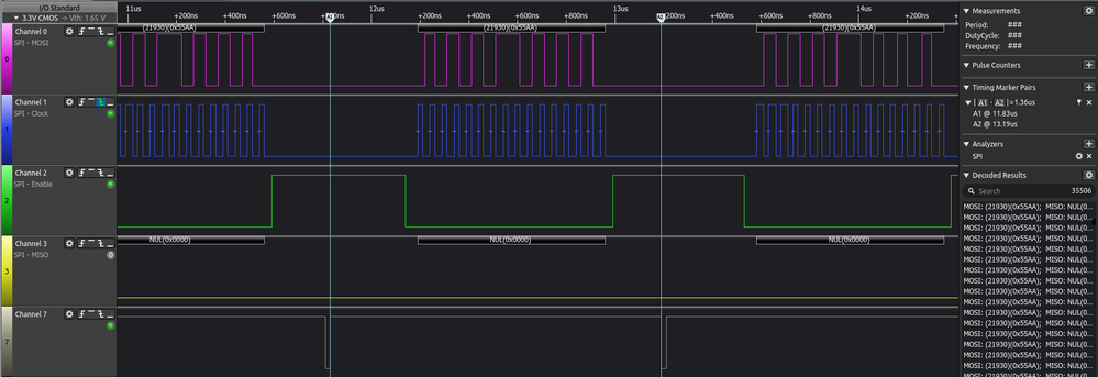

@bob S Thank you for the suggestion! With your advice, I optimized my code to this (where SPI_INIT function is equivalent to SPIM3_INIT as shown above):

With those changes it looks like a SPI transfer can clock in at ~1.36 us. Times 34 transfers --> 46.24 us. Which is just under the my 50 us deadline. Big improvement, but still not really good enough.
