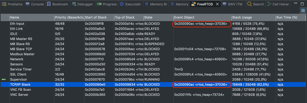

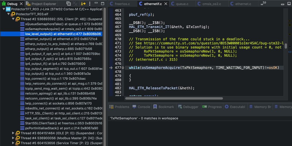

Update:
Both TCP/IP task and Eth input task both are blocked at the same event object 0x200090ac
2022-10-05 10:49 AM
