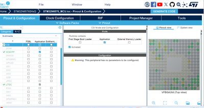

I have to implement the DCMIPP interface without using the BSP drivers. I am only using IMX335_reg.c,imx335_reg.h and imx335.c , imx335.h files and I am enabled DCMIPP interface in STM32CubeMX in CSI mode but when I enabling CSI it showing warning: This peripheral has no parameters to be configured.
I have attached the .ioc file of CSI interface. Is it possible to do without using BSP drivers. help me to complete the DCMIPP interface in STM32N6570-DK board. Thank you.
