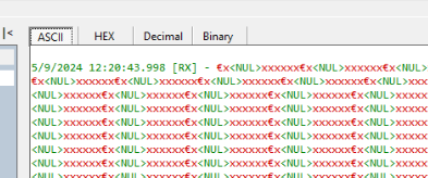

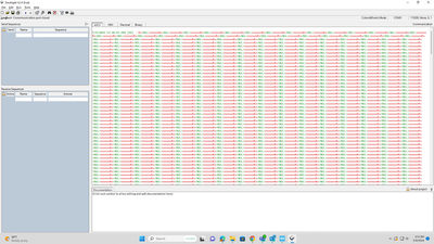

2024-05-09 1:42 AM
Here is the debug terminal:

@DivyaJayan wrote:After transmitting data, observed that the debug terminal is only receiving NUL characters.
I don't think that's what your terminal screenshot is showing?
That looks like it thinks it's receiving groups of 8 characters,, each followed by one NUL.
What do the Hex and Binary options show?
Again, probably the commonest cause of "junk characters" on a terminal like that is wrong baud rate.
To test baud rate, transmit a single uppercase 'U' in a tight loop, and look at the timing on an oscilloscope.
