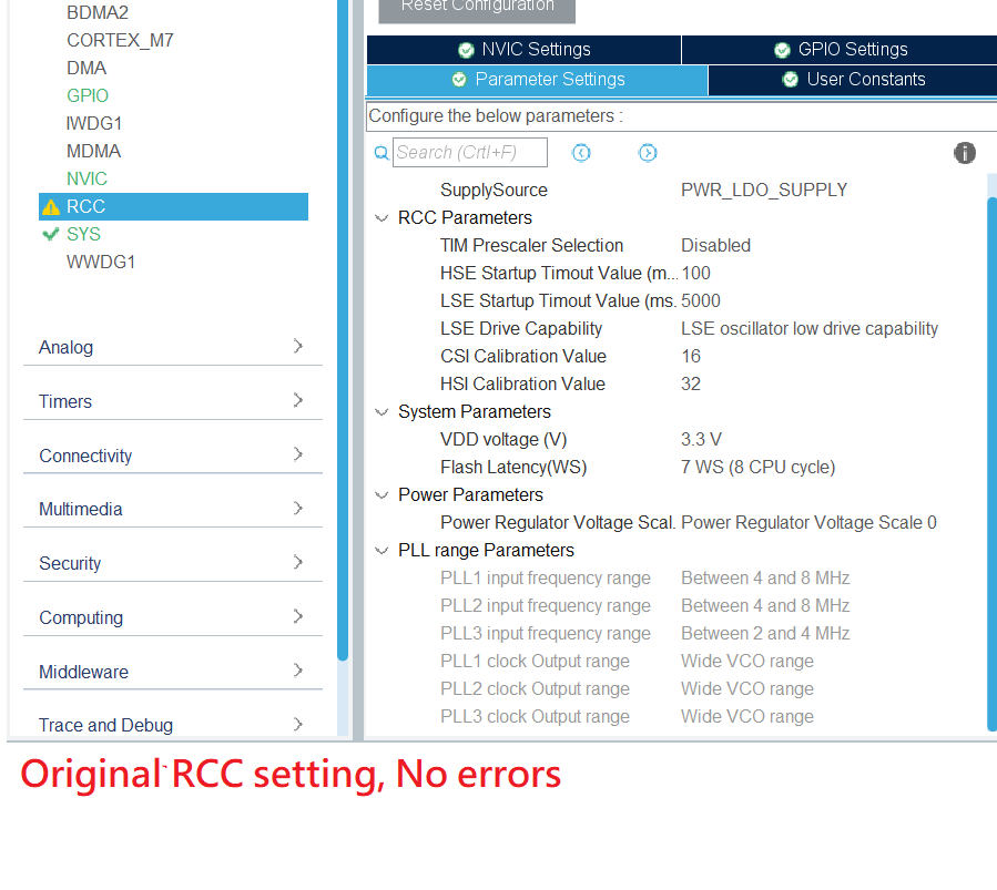

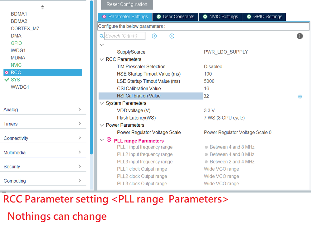

2021-01-25 5:22 AM
After I import a STM32H7A3ZIT6 from an old STM32H7A3ZIT6 project

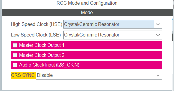

2021-01-25 5:31 AM
My RCC settings,It seems OK while disable HSE and LSE
2021-01-25 6:50 AM
Hi @cchen.1
Your first project was created with which CubeMX version ?
If it doesn't bother you, can you please share your old project ?
Thanks, Khouloud

Hi @cchen.1
Thanks for sharing your ioc file, it will be internally checked.
I'll be back to you as soon as possible for any update.
Khouloud
2021-01-27 7:30 AM
Hello @cchen.1
You're right, I reproduced the reported issue using your ioc file and it will be fixed.
Thanks for your contribution, Khouloud
