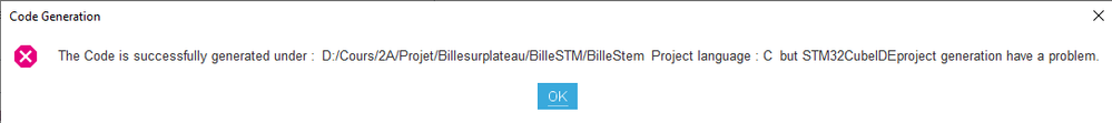

I have some problem with the latest version of cubeMX (v6.1.1), it won't create a project file for STM32 (well I would like to use simulink with mat/target before using STM32cubeIDE that's why I use cubeMx and the project work with µvision),
the configuration of my project are :
target board : NUCLEO-F446RE
target IDE : STM32cubeIDE 1.5.1
here is my error :
You can find the log in attach the log (log_CubeMx.txt) which consist of one generation done the 27/01 at 12:08 and the configuration file .ioc (BilleSTM32.ioc).
Thank you for your future help.
S. Dehais

Works like a charm on my side but possibly we are missing here some details about your running context.
Looking at your .log file sounds you've project on D:\. Where (which partition I mean) is STM32CubeIDE installed ? Where (which partition I mean) are your firmware repository set ? Are you using some special char or blank one as part of any of such path ?
... have already seen issue reported here Thanks such forum.
