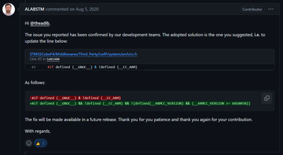

2024-07-01 6:53 PM - edited 2024-07-01 6:55 PM
Refer to HERE for the solution.
