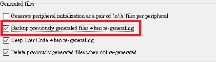

Also enable the backup functionality in the project settings
Good luck!
