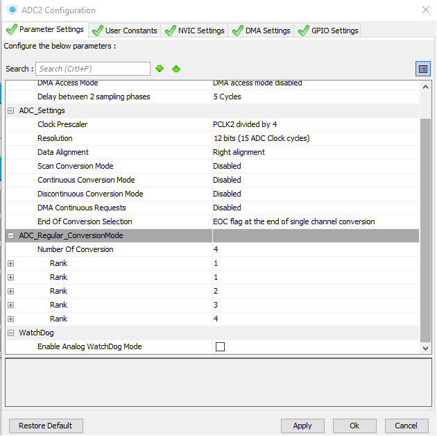

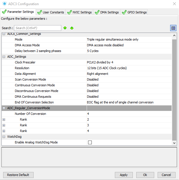

There is a bug in CubeMX version 4.25 in ADC configuration. I'm using STM32F746 MCU. In ADC2 configuration window there is one more rank displayed than number of conversion and for ADC3 there is one less. In generated file for ADC3, one channel is missing.

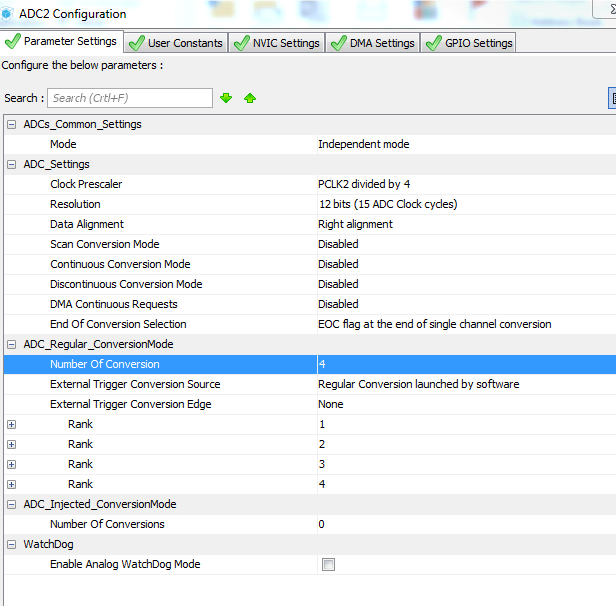

I am indeed using version 4. I tried to create fresh project and it workswithout problem.
My project was migrated from previous version of CubeMX to v4.25, so that probably caused the issue.
I've attached project file.
I also found that it can be fixed by disabling all inputs for ADC, so it's no longer in configuration tab, then re-enabling all inputs. Now when i open ADC configuration, modify and apply, problem is gone.
