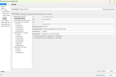

DP-FPU enables hardware double-precision floating-point calculations. In STM32CubeIDE, it’s activated by selecting FPv5-D16 as the floating-point unit and setting the ABI to Hardware implementation (-mfloat-abi=hard) in the project’s MCU settings.
Additionally, the startup code in system_stm32n6xx_fsbl.c configures the processor’s control registers to grant full access to the FPU by setting CP10 and CP11, ensuring that both secure and non-secure states can use the hardware FPU. Together, these settings guarantee that your application can efficiently execute both single and double-precision floating-point calculations using the microcontroller’s built-in FPU.
